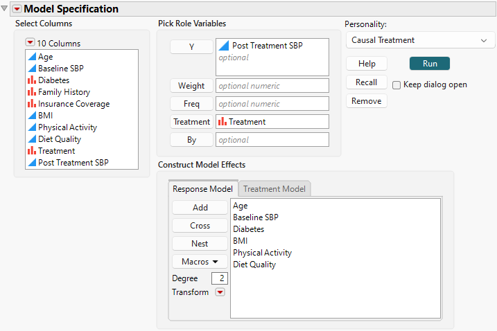

6. Select Age, Baseline SBP, Diabetes, BMI, Physical Activity, and Diet Quality and click Add on the Response Model tab.
Figure 14.2 Completed Fit Model Launch Window That Shows Response Model Tab

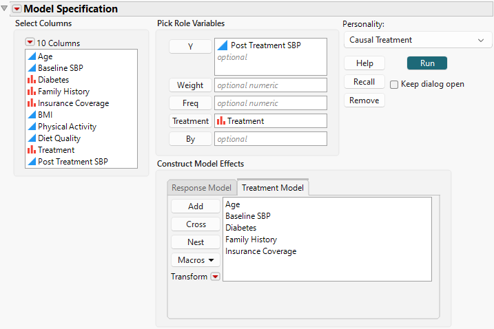

7. Select the Treatment Model tab.
8. Select Age through Insurance Coverage and click Add.
Figure 14.3 Completed Fit Model Launch Window That Shows Treatment Model Tab

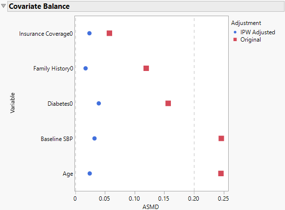

The Covariate Balance plot in Figure 14.5 shows the absolute standardized mean difference (ASMD) between the control and treatment groups for each variable that is specified in the treatment model. The red Original points show that the control and treatment groups have different profiles with regard to these covariates. The blue points show how these differences are reduced by inverse probability weight (IPW) adjustment. After IPW, the treatment and control groups should be similar across all levels of the covariates (except the treatment), as if treatment had been assigned randomly.
Figure 14.5 Covariate Balance Plot in the Model Report
