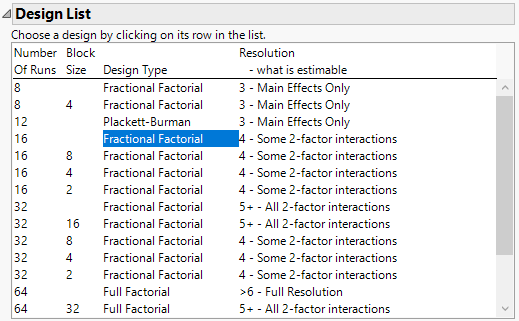

Potential designs appear in the Design List.
Figure 8.9 Screening Design List for Six Continuous Factors
8. Select the sixteen-run fractional factorial design with no blocks, shown highlighted in Figure 8.9.
9. Click Continue.
