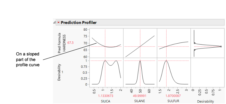

5. Click the Prediction Profiler red triangle and select Optimization and Desirability > Maximize Desirability to find the optimum factor settings for the target value of HARDNESS.
In the Prediction Profiler, notice that the SILICA factor’s optimum value is on a sloped part of a profile curve. This means that variations in SILICA settings impact the response, HARDNESS.

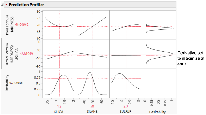

Figure 3.21 Derivative of the Prediction Formula with Respect to Silica

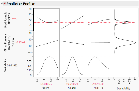

6. Click the Prediction Profiler red triangle and select Optimization and Desirability > Maximize Desirability to find the optimum values for the process factor, balancing for the noise factor.
This time, we have also hit the targeted value of HARDNESS, but our value of SILICA is on its flatter region. This means variation in SILICA does not transmit as much variation to HARDNESS as when it was set at a value on the steep part of the SILICA curve.

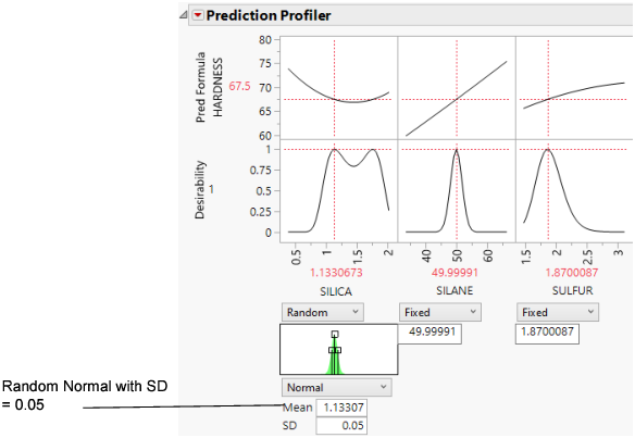

You can see the effect of accounting for the SILICA variation on the variance of the predictions by following these steps for each profiler (one without the noise factor, and one with the noise factor):
1. In the Profiler without the noise factor, click the Prediction Profiler red triangle and select Simulator.
2. Assign SILICA to have a random Normal distribution with a standard deviation of 0.05. Use the default setting for the mean.
Figure 3.23 Setting a Random Normal Distribution
3. Click Simulate.
