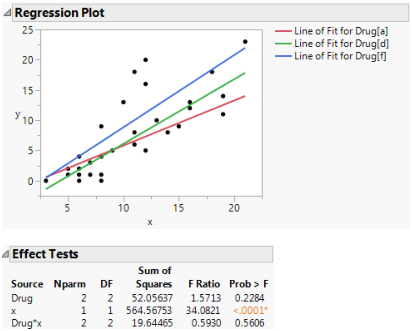

Regression Plot and Effect Tests
Use the Regression Plot to assess the model and to understand the impact of the covariate on the response. Use the Effects Tests for statistical tests of significance of the model effects.
Figure 4.23 Regression Plot and Effect Tests with Interaction
The Regression Plot shows that the response for Drug d and f increases at similar rates over the covariate, x. The response for Drug a tends to increase at a slower rate than for the other two drugs over the covariate, x. However, the Effect Test for the interaction has a p-value of 0.56. This is not significant, which indicates that the model does not need to include different slopes.
