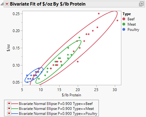

This example shows you how to use a grouping (By) variable in the Bivariate platform and add density ellipses to your data. The data table in this example identifies three different types of hot dogs: beef, meat, or poultry. You want to group the three types of hot dogs according to their cost variables.

9. Click the Bivariate Fit red triangle and select Density Ellipse > 0.90.
Color the points according to Type:
10. Right-click the scatterplot and select Row Legend.
11. Select Type in the column list and click OK.
Figure 5.19 Example of the Group By OptionĀ
The ellipses in Figure 5.19 show clearly how the different types of hot dogs cluster with respect to the cost variables.
