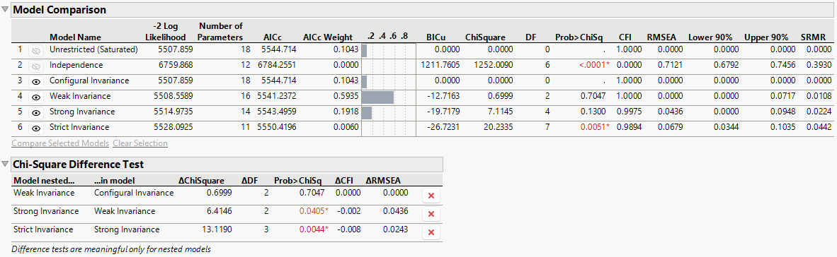

The report that appears includes Model Comparison and Chi-Square Difference Test reports, along with individual Structural Equation Model reports for each specified model. The Structural Equation Model reports are presented in separate tabs for each group.
Figure 8.29 Model Comparison and Chi-Square Difference Test Reports
The Model Comparison and Chi-Square Difference Test reports enable you to assess model fit across the different levels of measurement invariance. Among the tested models, the Strong Invariance model has the most evidence of best fit. This model constrains both factor loadings and intercepts to be equal across groups, which provides meaningful comparisons of latent means across genders. The CFI (0.9974) and RMSEA (0.0456) values for this model indicate an acceptable model fit. Moreover, despite the large sample size, the Chi-Square Difference Test report indicates that there is no significant difference between the Strong Invariance model and the less restrictive Weak Invariance model. This suggests that the Strong Invariance model fits the data well without sacrificing model fit. Although the Strict Invariance model (which also constrains residual variances to be equal across groups) was tested, this level of invariance is generally not necessary for meaningful cross-group comparisons of latent means. The significant drop in model fit from the Strong Invariance model to the Strict Invariance model suggests that equal residual variances across groups might be too restrictive and unnecessary. Therefore, you choose to use the Strong Invariance model as the final model, which is sufficient for comparing latent means across groups.

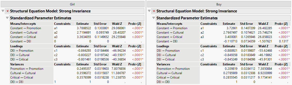

Figure 8.30 Standardized Parameter Estimates for the Girl and Boy Groups
Figure 8.30 shows the standardized parameter estimates for the Strong Invariance model for the Girl and Boy groups, respectively. These estimates provide insight into the relationships between the latent variable DEI and the observed variables for both gender groups. Since strong invariance is assumed, the unstandardized factor loadings are constrained to be equal across groups, with small variations in the standardized estimates due to group-specific scaling. The reports show that the loadings for DEI on Promotion, Cultural, and Critical are statistically significant for both boys and girls (p-value < 0.0001 across all loadings). Although the loadings appear slightly stronger for boys than girls, these differences are due to group-specific scaling rather than actual structural differences, as the strong invariance assumption constrains these relationships to be the same across groups.
Overall, the Strong Invariance model confirms that DEI has the same conceptualization and is consistently measured across both boys and girls. Although there are minor differences in standardized estimates, they do not affect the overall structure or interpretation of the latent variable relationships. This model supports the robustness of the DEI construct across genders while highlighting subtle differences in how DEI explains variance in specific indicators.
