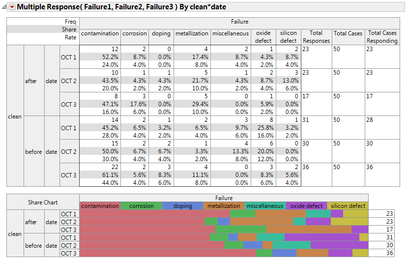

Figure 3.36 Multiple Response Report
The crosstab table has a row for each batch and a column for each defect type. The frequency, share, and rate of each defect within each batch are shown in the table cells. For example, for the batch after cleaning on OCT 1, there were 12 contamination defects representing 12/23 or 52.2% of the defects for that batch. The 12 contamination defects were from 50 units. For each clean and date combination, there were 50 total units. Each unit could have one or more defects. Therefore, the rate of contamination per unit was 24%. For the batch before cleaning on OCT 1, the Total Cases Responding is 28. The Total Responses count is 31, because three of the cases reported two defects.

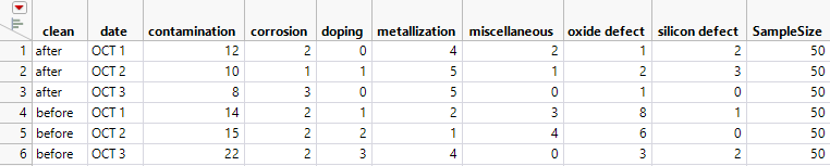

This example uses a sample data table has a row for each batch, a column for each defect type, and a column for the batch size. The data entries in the defect columns are the number of occurrences of each defect in the batch.
Figure 3.40 Failure3Freq.jmp Data Table

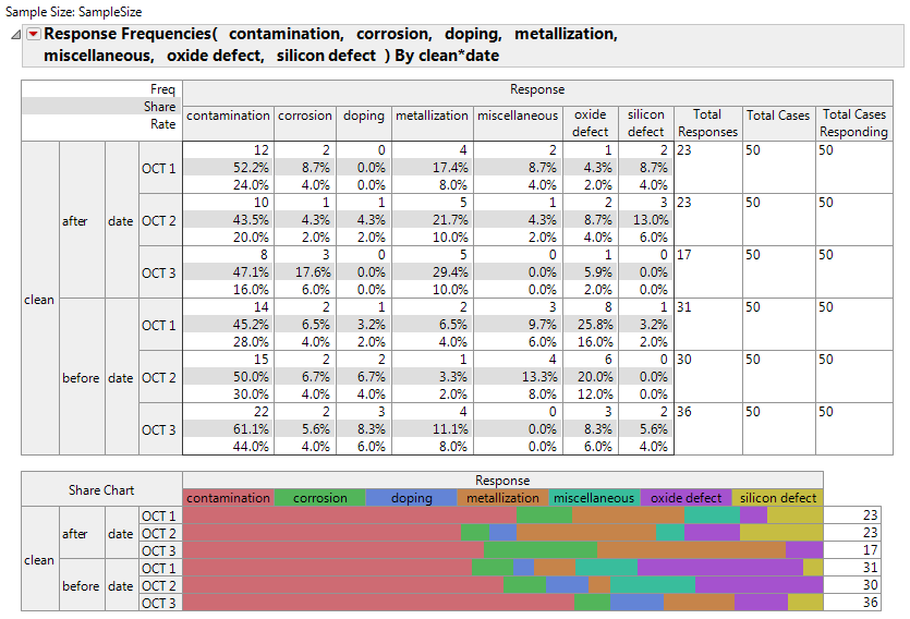

Figure 3.41 Defect Rate Output
Defect Rate Output
The resulting output is the same as that in Figure 3.36 with the exception of the Total Cases Responding column in the crosstab table. Here, the defect counts were summarized. From the summarized table, there is no record of the number of units with zero defects. Thus, the Total Cases Responding is the full batch size of 50 for each batch.
