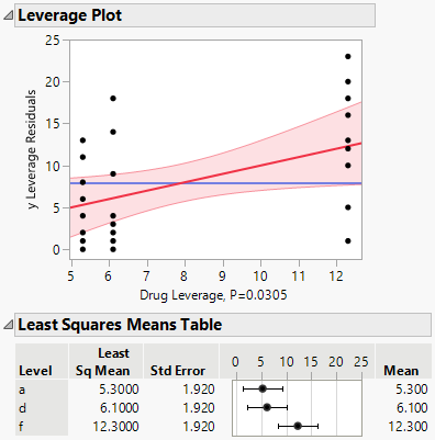

Figure 4.5 shows the Leverage Plot and the LS Means Table for the Drug effect. Figure 4.6 shows the Parameter Estimates and the Effect Tests reports for the one-way analysis of the drug data.
Figure 4.5 Leverage Plot and LS Means Table for Drug

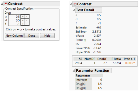

The Drug effect can be studied in more detail by using a contrast of the least squares means:
1. Click the Drug red triangle and select LSMeans Contrast.
2. Click the + boxes for drugs a and d, and the - box for drug f to define the contrast that compares the average of drugs a and d to f (shown in Figure 4.7).
3. Click Done.
Figure 4.7 Contrast Example for the Drug Experiment
The Contrast report shows that the LSMean for drug f is significantly different from the average of the LSMeans of the other two drugs.
