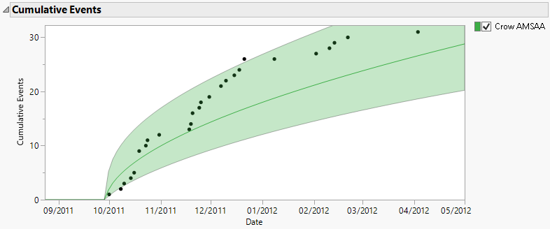

7. Click the Reliability Growth red triangle and select Fit Model > Crow AMSAA.
The Cumulative Events plot in the Observed Data report updates to show the model. The model does not seem to fit the data very well.
Figure 12.25 Cumulative Events Plot with Crow AMSAA ModelĀ

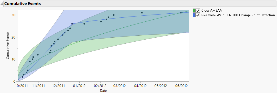

8. Click the Reliability Growth red triangle and select Fit Model > Piecewise Weibull NHPP Change Point Detection.
The Cumulative Events plot in the Observed Data report updates to show the piecewise model fit using change-point detection. Both models are shown in Figure 12.26. Though the data are rather sparse, the piecewise model seems to provide a better fit to the data.
Figure 12.26 Cumulative Events Plot with Two ModelsĀ
