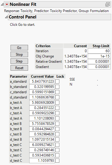

The Nonlinear Fit window appears. In the Control Panel, parameter values and locking options are shown. The letters listed before each parameter correspond to variables from the Prediction Model in the Fit Curve function.
Figure 15.20 Nonlinear Fit Control Panel
Tip: You can lock parameters if you know the values from prior information.

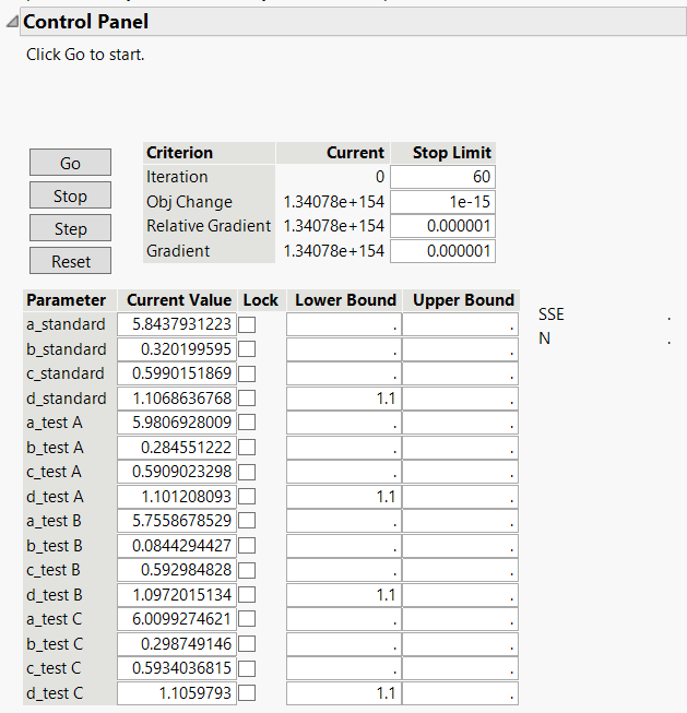

8. Click the Nonlinear Fit red triangle and select Parameter Bounds.
Options for setting the lower and upper parameters appear next to the parameters.
9. Set the lower bounds for the parameters as shown in Figure 15.21. You know from prior experience that the maximum toxicity of the drug is at least 1.1.
Figure 15.21 Setting Parameter Bounds
10. Click Go.

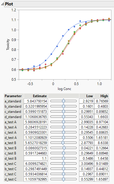

The final parameter estimates are shown in the Solution report, along with other fit statistics. The fitted model is shown on the plot.
Figure 15.22 Nonlinear Fit Plot and Parameter Estimates
Options below the plot allow for adjusting parameter limits and estimates.
