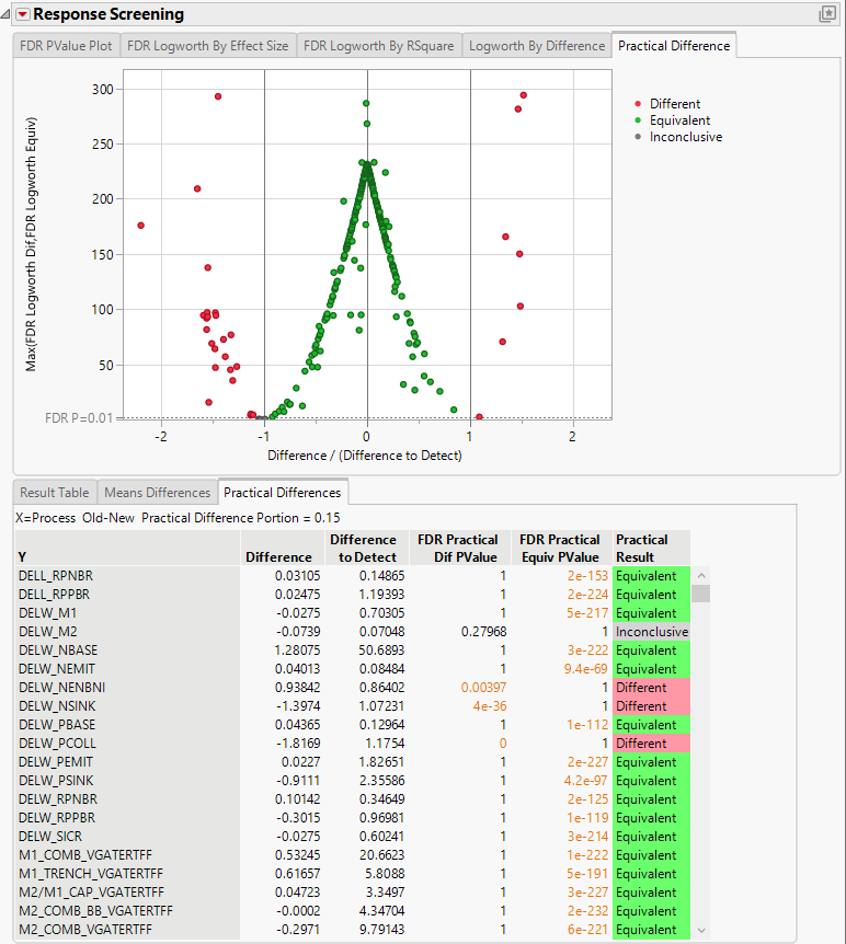

Figure 25.8 Response Screening Practical Difference Report
The Response Screening report shows the Practical Difference plot and a portion of the Practical Differences table. Each row in the Practical Differences table represents a response and provides information about tests of the New and the Old levels of Process.
Because specification limits are not saved as column properties in Probe.jmp, JMP calculates a value of the practical difference for each response. The practical difference portion of 0.15 that you specified is multiplied by an estimate of the 6σ range of the response. This value is used in testing for practical difference and equivalence. It is shown in the Difference to detect column. If the value in the Difference column is larger than the value in the Difference to Detect column, the levels are considered practically different for the corresponding response. Responses that have practically different results are colored red in both the Practical Difference plot and the Practical Differences table.
9. Click the Response Screening red triangle and select Save Tables > Save Means Differences.
In the data table, the FDR PValue column shows responses whose p-values indicate significance. The FDR Practical Diff PValue and FDR Practical Equiv PValue columns give the p-values for tests of practical difference and practical equivalence. Note that many columns show statistically significant differences, but do not show practically significant differences.

Figure 25.9 shows the distribution of results for practical significance. Only 36 tests are different, as determined by testing for the specified practical difference. For 6 of the responses, the tests were inconclusive. You cannot tell whether the responses result in a practical difference across Process.
