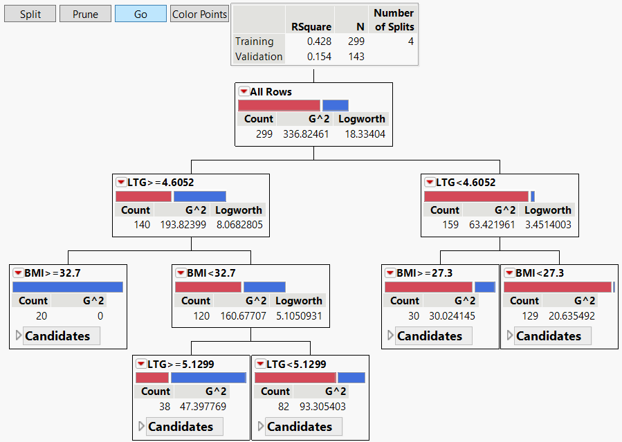

7. On the platform report window, click Go to perform automatic splitting.
Note: Because you are using a random Validation Portion, your results differ from those in Figure 4.2.
Figure 4.2 Partition Report for Diabetes
Automatic splitting resulted in four splits. The final RSquare for the Validation set is 0.154. The decision tree shows the four splits and the counts of observations in each split.

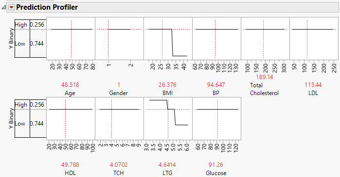

9. Click the red triangle next to Partition for Y Binary and select Profiler.
Figure 4.4 Profiler for Partition Model
The profiler enables you to change the values of BMI and LTG to obtain the predicted Y Binary outcome. No other factors had a split in the partition model. Their profiles are flat lines.
