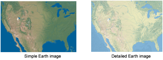

JMP provides two levels of earth imagery; simple and detailed. Both maps show features such as bodies of water and terrain. However, detailed maps show more precise terrain. With detailed maps, you can zoom in farther, and the map features remain clear. Image maps are raster images. The maps wrap horizontally, so you continue to see map details as you scroll from left to right. The maps do not wrap vertically. Beyond the -90 and 90 y-axis range, a plain background appears instead of the map.
Figure 12.17 Examples of Simple and Detailed Maps
As its name suggests, Simple Earth is a relatively unadorned image of the Earth’s geography. It does not show clouds or arctic ice, and it uses a green and brown color scheme for the land and a constant deep blue for water. Detailed Earth has a softer color scheme than Simple Earth. It has lighter greens and browns for the land and variation in the blue for the water. Detailed Earth also has a slightly higher resolution than Simple Earth. The higher resolution lets you zoom in to a graph further with Detailed Earth than with Simple Earth before the quality of the background image begins to blur.

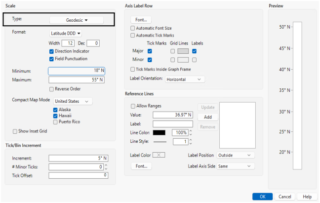

Simple Earth and Detailed Earth both support a geodesic scaling. In Figure 12.17, the Earth appears as a rectangle, where the width is twice as wide as the height. If you took this rectangle and rolled it up, you would have a cylinder. In reality, you know that the Earth does not form a cylinder, but rather a sphere. You can use a geodesic scaling, which transforms the map to a more realistic representation of the Earth. To use the geodesic scaling, change the type of scale on the axes.
To change the axes scale
1. Right-click the X or Y axis and select Axis Settings.
2. Make sure that the Scale Type is set to Geodesic.
Figure 12.18 Y Axis Setting Window

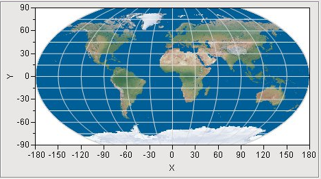

It is important to note that you must set the scale to Geodesic for both axes to get the transformation. You do not see a change in the map after setting only one of the axes. In the following figure, Simple Earth is used as the background map with both axes set to use a geodesic scale. The axes lines are turned on as well. Notice the longitudinal lines are now curved, instead of straight.
Figure 12.19 Simple Earth Background Map - Axes Set to Geodesic Scale

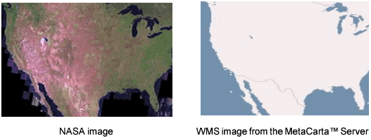

The National Aeronautics and Space Administration (NASA) and other organizations provide map image data by using a protocol called Web Map Service (WMS). These maps have the advantage of showing the most up-to-date geographical information. However, the display of the maps can be slow depending on the response time of the server, and the sites can change or disappear at any time. An internet connection is required to access the information.
Figure 12.20 Examples of NASA and WMS Maps

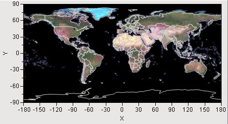

The NASA server provides maps for the entire Earth. The following figure displays the Earth by using the NASA server as its source for the background map. The boundary map shows the outlines of the countries.
Figure 12.21 NASA Server Map Example

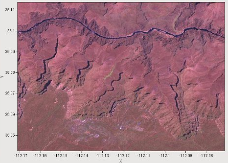

Not only does this server cover the entire Earth, but you can also zoom in on a much smaller area of the Earth and still get a reasonable map. The following figure displays the Colorado River that runs through the Grand Canyon in Arizona. The Grand Canyon Village is visible in the bottom of the map.
Figure 12.22 NASA Server Map Example - Zoom In on Colorado
If you look at the axes values, you can see that the area is less than 1/10° by 1/10°. The Simple Earth and Detailed Earth background maps do not display that type of resolution. The NASA server provides a more detailed view of any land mass on Earth. However, water is simply filled in as black. The NASA server is free to access, but it is also limited in availability. If the server is temporarily not available or becomes overloaded with requests, it delivers an error message instead of the requested map.
Another internet-based option for background maps is a Web Map Service (WMS). The WMS option enables you to specify any server that supports the WMS interface. The NASA server is an example of a WMS server, but this example provides the URL and a layer name for you. With the WMS option, you must know the URL to the WMS server and a layer name that is supported by the server. Most WMS servers support multiple layers. For example, one layer can show terrain, another layer can show roads, and still another layer can include water, such as rivers and lakes. By specifying the URL for the server and the layer, JMP can make a request to the server and then display the map that is returned.
Unlike with simple and detailed maps, WMS maps do not wrap. You can scroll horizontally and vertically. However, beyond the -180 to 180 (horizontal axis) and -90 to 90 (vertical axis) ranges, a plain background appears instead of the map. The limits of the axes are used to define the limits of the map that is displayed.
