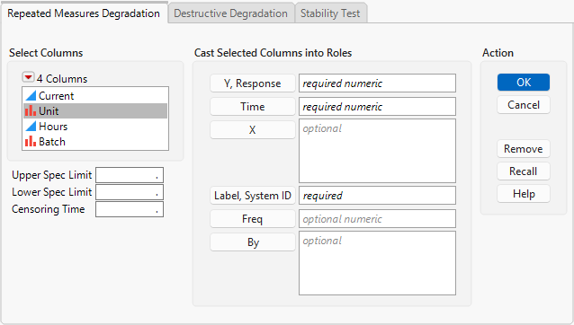

Launch the Degradation platform by selecting Analyze > Reliability and Survival > Degradation.
Figure 16.3 The Degradation Launch Window

The launch window is split into three tabs, representing three different types of analyses:
Repeated Measures Degradation
Performs linear or nonlinear repeated measures degradation analysis. This option allows only one Y, Response variable. It does not allow censoring.
Destructive Degradation
Performs linear or nonlinear destructive degradation analysis. Choose this type of analysis if units are destroyed during the measurement process. This option allows censoring. See Custom Destructive Degradation Models.
Note: The Destructive Degradation platform provides a flexible collection of predefined models for destructive testing. See “Destructive Degradation”.
Stability Test
Performs a stability analysis for setting pharmaceutical product expiration dates. This option allows only one Y, Response variable. See Stability Analysis in the Degradation Platform.
