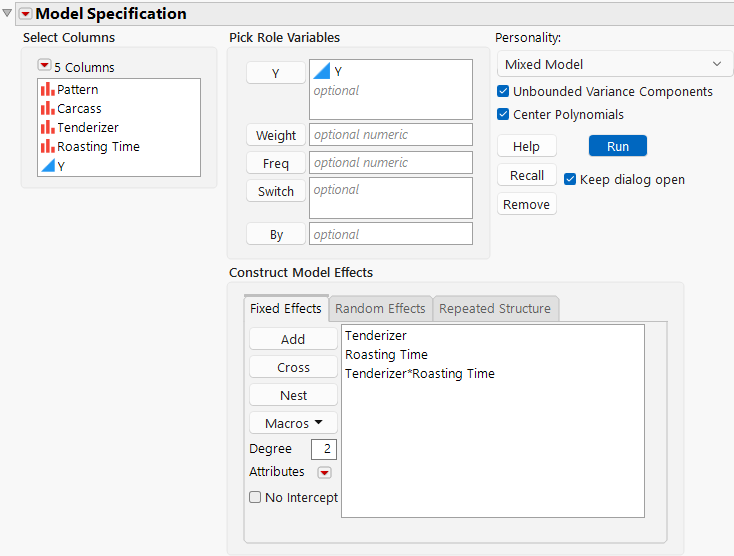

Use the Fixed Effects tab to add fixed effects to the model. Use the Add, Cross, Nest, Macros, and Attributes options as needed. For more information about these options, see “Model Specification”.
Note: If a continuous column is involved in a random effect and it is involved in an interaction with a categorical effect, the continuous column is not centered, even if the Center Polynomials option in the Model Specifications red triangle menu is selected.
The fixed effects for analysis of the Split Plot.jmp sample data table appear in Figure 8.7. Note that it is possible to have no fixed effects in the model. For an example, see Example of a Uniformity Trial.

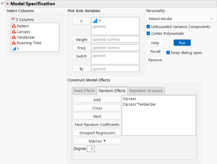

Variance Components
For a traditional variance component model, use the Add, Cross, or Nest options to specify terms such as random blocks, whole plot error terms, and subplot error terms. For more information about these options, see “Model Specification”.
Figure 8.8 shows the random effects specification for the Split Plot.jmp sample data where Carcass is a random block. Example of a Split Plot Experiment describes the example in detail.

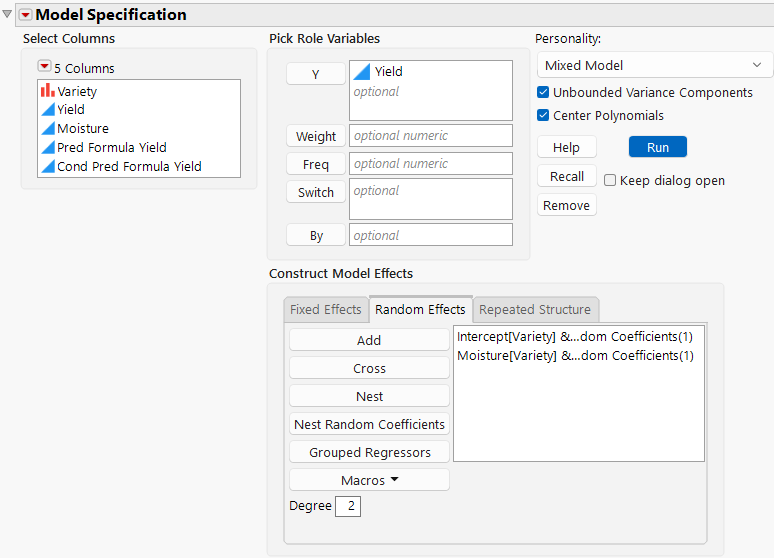

Random Coefficients
To construct random coefficients models, use the Nest Random Coefficients button to create groups of random coefficients.
1. Select the continuous columns from the Select Columns list that are predictors.
2. Select the Random Effects tab and then Add.
3. Select these effects in the Random Effects tab. Also select the column that contains the random effect whose levels define the individual regression models. This column is essentially the subject in a random statement in SAS PROC MIXED.
4. Click the Nest Random Coefficients button.
This last step creates random intercept and random slope effects that are correlated within the levels of the random effect. The subject is nested within the other effects due to the variability among subjects. If you believed that the intercept might be fixed for all groups, you would select Intercept[<group>]&Random Coefficients(1) and then click Remove.
You can define multiple groups of random coefficients in this fashion, as in hierarchical linear models. This might be necessary when you have both a random batch effect and a random batch by treatment effect on the slope and intercept coefficients. This might also be necessary in a hierarchical linear model: when you have a random student effect and random school effect on achievement scores and students are nested within school.
Random coefficients are modeled using an unstructured covariance structure. Figure 8.9 shows the random coefficients specification for the Wheat.jmp sample data. See also Example Using the Mixed Model Personality.
