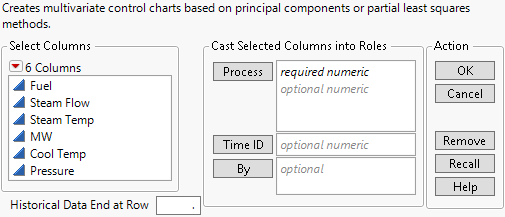

Launch the Model Driven Multivariate Control Chart (MDMVCC) platform by selecting Analyze > Quality and Process > Model Driven Multivariate Control Chart.
Figure 12.6 The Model Driven Multivariate Control Chart Launch Window
The MDMVCC platform launch window contains the following options:
Process
Assigns the process columns. See Data Format.
Time ID
Assigns a column that is used to identify samples. If no Time ID is assigned, the row number identifies the observations. If the Time ID column is a time, the time identifies each sample. Otherwise, the numeric value of the Time ID identifies each sample.
By
Produces a separate report for each level of the By variable. If more than one By variable is assigned, a separate report is produced for each possible combination of the By variables.
Historical Data End at Row
Specifies a row number to indicate where historical data end. This enables you to calculate chart limits based on historical data. Both historical and current data are plotted on the charts. Historical data are also known as Phase I data, and current data are also known as Phase II data.
