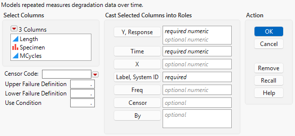

Launch the Repeated Measures Degradation platform by selecting Analyze > Reliability and Survival > Repeated Measures Degradation.
Figure 9.7 The Repeated Measures Degradation Launch Window
The Repeated Measures Degradation launch window contains the following options:
Y, Response
Identifies the column that contains the degradation measurements. When your response values are interval-censored, you can enter two columns. See Specify Two Y Columns.
Time
Identifies the column that contains the time values.
X
Identifies the column that contains an explanatory variable. Use this role to specify the accelerating factor in an accelerated degradation model.
Label, System ID
Identifies the column that contains the unit IDs.
Freq
Identifies a column that contains a frequency for each row.
Censor
Identifies a column that designates if a response measurement is censored.
By
Identifies a variable to produce an analysis for each level of the By variable.
Censor Code
Specifies the value in the Censor column that designates censored observations. After a Censor column is selected, JMP attempts to automatically detect the censor code and display it in the box. To change this, click the red triangle and select from a list of values. You can also enter a different value in the box. If the Censor column contains a Value Labels column property, the value labels appear in the list of values. Missing values are excluded from the analysis.
Upper Failure Definition
Specifies a value of the response that represents a failure for values greater than it.
Lower Failure Definition
Specifies a value of the response that represents a failure for values less than it.
Use Condition
Specifies a value for the explanatory variable, X, of the acceleration factor. This value represents a value of the X that is appropriate for normal use.
