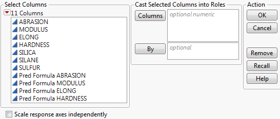

Figure 5.5 Surface Plot Launch Window
Columns
Specifies the columns that you want to plot. Only numeric variables can be assigned to the Columns role.
By
Specifies a variable to create separate surface plots for each level of the variable.
Scale response axes independently
Assigns a separate scale to each response on the surface plot.
Note: When not selected, the axis scale for all responses is the same as the scale for the first item entered in the Columns role.
