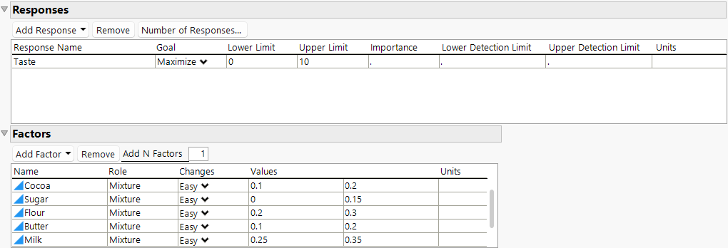

6. Select Help > Sample Data Folder and open Design Experiment/Cake Factors.jmp.
7. Click the Custom Design red triangle and select Load Factors.
Figure 5.54 Completed Responses and Factors
Note that the factors are all mixture factors. The Values that define the range of settings for the experiment vary from factor to factor.

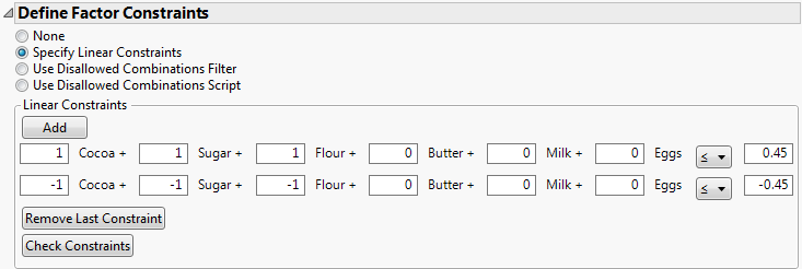

8. In the Define Factor Constraints section, select Specify Linear Constraints.
9. In the Linear Constraints panel, click Add twice.
10. Enter the constraints shown in Figure 5.55.
Figure 5.55 Define Factor Constraints
Note that the second constraint is equivalent to specifying that the sum of Cocoa, Sugar, and Flour is greater than or equal to 0.45. The two constraints together imply that Cocoa, Sugar, and Flour comprise exactly 45% of the mixture, ensuring that the wet factors constitute the remaining 55%.

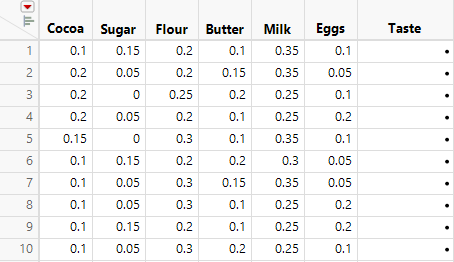

17. Click Make Table.
Figure 5.56 Mixture of Mixtures Design
The settings for the dry ingredients, Cocoa, Sugar, and Flour, sum to 45% of the mixture and the settings for the wet ingredients, Butter, Milk, and Eggs, sum to 55% of the mixture. The settings also conform to the upper and lower limits given in the Factors section.

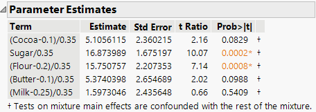

The main effect due to Eggs is not included. To avoid model singularities, the Eggs effect was excluded from the Model section in the Custom Design window. The five effects are designated as Response Surface and Mixture effects.
3. Click Run.
A JMP Alert appears, notifying you that the Profiler cannot be shown because of the mixture of mixtures constraint on the subsets of factors.
4. Click OK to dismiss the JMP Alert.
The Parameter Estimates report indicates that Sugar and Flour are significant at the 0.05 level.
