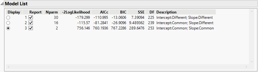

The Model List section of the Degradation Data Analysis report contains summary statistics and other options for every fitted model. Figure 16.17 shows an example of the Model List with summaries for three models.
Caution: Models are not comparable if the transformations on the Y response variable are customized or are not the same across models.
Figure 16.17 Model List
Model List
Display
Select the model that you want represented in the Overlay plot, Residual Plot, Inverse Prediction plot, and Prediction Graph.
Report
Select the check boxes to display the report for a model. For more information about the reports, see Reports.
Nparm
The number of parameters estimated for the model.
-2LogLikelihood
Twice the negative of the log-likelihood. See “Likelihood, AICc, and BIC” in Fitting Linear Models.
AICc
The corrected Akaike Criterion. See “Likelihood, AICc, and BIC” in Fitting Linear Models.
BIC
The Bayesian Information Criterion. See “Likelihood, AICc, and BIC” in Fitting Linear Models.
SSE
(Appears only for Repeated Measures Degradation model reports.) The error sums-of-squares for the model.
DF
(Appears only for Repeated Measures Degradation model reports.) The error degrees of freedom.
Description
A description of the model.
