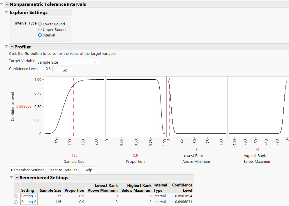

Example of the Nonparametric Tolerance Intervals Explorer
In this example, use the Nonparametric Tolerance Intervals Explorer to explore the sample size and order statistics to define tolerance intervals to cover 90% of your population with 90% confidence.
1. Select DOE > Sample Size Explorers > Reliability > Nonparametric Tolerance Intervals.
2. Leave Interval Type set to Interval for estimating a sample size for a two-sided tolerance interval.
3. Leave Target Variable set to Sample Size.
4. Set Confidence Level to 0.90.
5. Click Go.
6. Click Remember Settings.
7. In the window, leave the default setting name and click OK.
8. In the profiler, set the Lowest Rank Above Minimum to 3.
9. In the profiler, set the Highest Rank Below Maximum to -3.
10. Click Go.
11. Click Remember Settings.
12. In the window, leave the default setting name and click OK.
Figure 29.13 Nonparametric Tolerance Intervals Explorer
The first remembered setting saved the sample size estimation of 37 samples. The minimum and maximum observations from a sample size of 37 defines a tolerance interval that covers 90% of your population with 89.63% confidence. The second remembered setting saved the sample size estimation of 115 samples. The 3rd and 112th order statistics from a sample size of 115 defines a tolerance interval that covers 90% of your population with 89.86% confidence.
