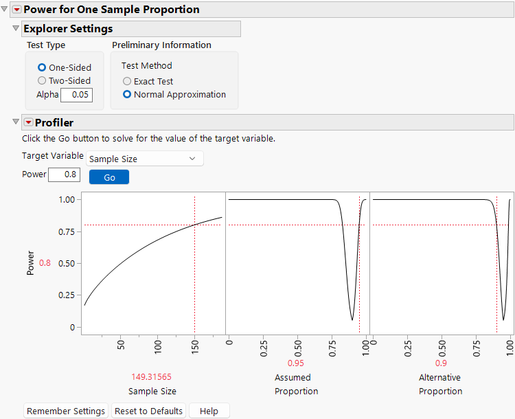

In this example, use the Power Explorer for One Sample Proportion to help determine the number of samples to test to demonstrate a process success rate of least 90%. You would like your study to have at least 80% power to demonstrate a success rate of at least 90% assuming that you achieve a success rate of at least a 95% at a significance level of α = 0.05. You use a one-sided test using the normal approximation methodology.
1. Select DOE > Sample Size Explorers > Power > Power for One Sample Proportion.
2. Select One-Sided for Test Type.
3. Leave Alpha set to 0.05.
4. Select Normal Approximation for Test Method.
5. Leave Target Variable set to Sample Size.
6. Leave Power set to 0.8.
7. In the profiler, use the slider or click on the red value for a text box to set the Assumed Proportion to 0.95. This is the proportion you assume that you can achieve.
8. In the profiler, set the Alternative Proportion to 0.90. This is the minimum proportion that you want to demonstrate that your process can achieve.
9. Click Go.
Figure 29.3 One Sample Proportion Explorer
Note that a sample size of 150 is needed to show that an expected success rate of 95% is greater than 90% with 80% power using a one-sided test of proportions using the normal approximation methodology.
