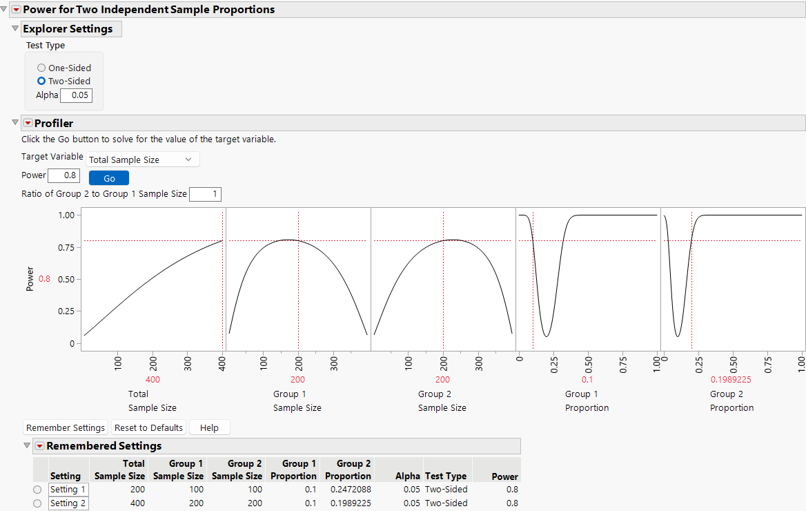

Example of Power Explorer for Two Independent Sample Proportions
In this example, use the Power Explorer for Two Independent Sample Proportions to evaluate the difference in testing 200 or 400 samples to determine the difference in misclassification rates of a diagnostic model that is applied at two different sites.
You would like to evaluate a hypothesis test with at least 80% power to test for the difference in proportions at a significance level of α = 0.05. Assume that the diagnostic test has a misclassification rate of 10% and consider total sample sizes of 200 and 400.
1. Select DOE > Sample Size Explorers > Power > Power for Two Independent Sample Proportions.
2. Leave Test Type set to Two-Sided.
3. Leave Alpha set to 0.05.
4. Select Group 2 Proportion for Target Variable.
5. Leave Power set to 0.8.
6. In the profiler, set Total Sample Size to 200. Note that the group sample sizes update to 100.
7. In the profiler, set Group 1 Proportion to 0.1. This is the assumed misclassification rate.
8. Click Go to solve for Group 2 Proportion.
9. Click Remember Settings to save the results showing that with 100 samples per group a misclassification rate of 0.25 would be found to be statistically significantly different from the 0.1 of Group 1. Maintain the default name and click OK.
10. Set Total Sample size to 400. Note the group sample sizes are each 200.
11. Click Go to solve for Group 2 Proportion.
12. Click Remember Settings to save the results showing that with 200 samples per group the misclassification rate of 0.20 would be found to be statistically significantly different from the 0.1 of Group 1. Maintain the default name and click OK.
Figure 29.5 Two Independent Sample Proportions Explorer
An increase in total sample size from 200 to 400 samples enables you to detect a 0.05 smaller difference in proportions between the two groups.
