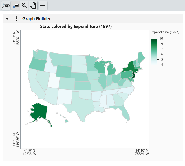

To export a single JMP report as interactive HTML, use the Export as Interactive HTML with Data option to create a single web page.
1. In JMP, create the report and make it the active window.
Note: If a report contains a Local Data Filter, it is static in the web report and users cannot change the selections. To make the Local Data Filter interactive, deselect the Include mode. (In Graph Builder, to see the Include mode, select Show Modes from the Local Data Filter red triangle.)
2. Select File > Export, select Interactive HTML with Data, and click Next.
3. Navigate to where you want to save the file.
4. (Optional) Rename the file.
5. Keep the Open the file after saving option selected.
6. Click Save.
The output is saved in the selected folder and opens in a browser.

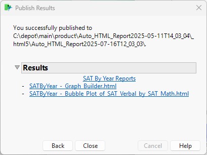

To publish multiple JMP reports as interactive HTML, use the Publish to File option, which creates an index page that contains the reports.
Tip: When you publish multiple JMP reports, you specify where to save the index page and report files. You can choose a shared network folder and provide the location to others, or choose a folder on your computer and zip the files before sharing. This is particularly helpful if you are sharing with people who do not use JMP.
1. In JMP, create the reports.
2. From a report window, select File > Publish > Publish to File.
3. Select the reports that you want to publish.
4. (Optional) Change where the parent folder resides or change the name of the subfolder that will contain the reports.
5. Click Next.
6. Enter a title for the index page.
You can also update the report titles.
7. (Optional) Change additional options.
See Interactive HTML Report Options.
8. Click Publish.
