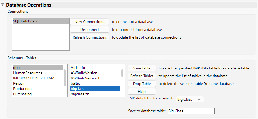

2. Select File > Database > Save Table.
Figure 11.1 The Database Save Table Window
3. In the Connections box, highlight the name of the database to which you want to save the file (Figure 11.1).
The Connections box contains a list of databases to which your system is connected.
4. From the JMP data table to be saved list, select the open JMP data table that you want to save to the database.
5. In the Save to database table box, enter the name that you want the table to have when you save it in the database.
6. Click Save Table.
