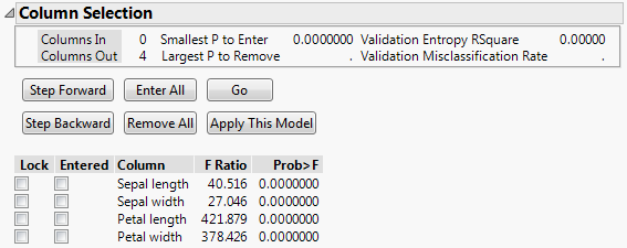

If you select the Stepwise Variable Selection option in the launch window, the Discriminant Analysis report contains a Column Selection panel. You can perform stepwise analysis using the buttons to select variables or selecting them manually with the Lock and Entered check boxes. Based on your selection F ratios and p-values are updated. For more information about how these are updated, see Updating the F Ratio and Prob>F.
If you specify any type of validation set, a Go button appears. When you click Go, JMP uses the validation set statistics to determine how many steps to take.
Figure 5.4 Column Selection Panel for Iris.jmp with a Validation Set

Buttons
Step Forward
Enters the most significant covariate from the covariates not yet entered. If a validation set is used, the Prob>F values are based on the training set.
Step Backward
Removes the least significant covariate from the covariates entered but not locked. If a validation set is used, Prob>F values are based on the training set.
Enter All
Enters all covariates by checking all covariates that are not locked in the Entered column.
Remove All
Removes all covariates that are not locked by deselecting them in the Entered column.
Apply this Model
Produces a discriminant analysis report based on the covariates that are checked in the Entered columns. The Select Columns outline is closed and the Discriminant Analysis window is updated to show analysis results based on your selected Discriminant Method.
Tip: After you click Apply this Model, the columns that you select appear at the top of the Score Summaries report.
Go
Enters covariates in forward steps until the Validation Entropy RSquare begins to decrease. Entry terminates when two forward steps are taken without improving the Validation Entropy RSquare. Available only with excluded rows in JMP or a validation column in JMP Pro.
Columns
Lock
Forces a covariate to stay in its current state regardless of any stepping using the buttons.
Note the following conditions:
– If you enter a covariate and then select Lock for that covariate, it remains in the model regardless of selections made using the control buttons. The Entered box for the locked covariate shows a dimmed check mark to indicate that it is in the model.
– If you select Lock for a covariate that is not Entered, it is not entered into the model regardless of selections made using the control buttons.
Entered
Indicates which columns are currently in the model. You can manually select columns in or out of the model. A dimmed check mark indicates a locked covariate that has been entered into the model.
Column
The covariate of interest.
F Ratio
The F ratio for a test for the group variable obtained using an analysis of covariance model. See Updating the F Ratio and Prob>F.
Prob > F
The p-value for a test for the group variable obtained using an analysis of covariance model. See Updating the F Ratio and Prob>F.
