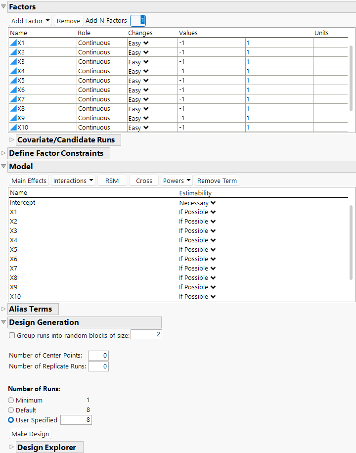

1. Select DOE > Custom Design.
2. Type 12 next to Add N Factors.
3. Click Add Factor > Continuous.
4. Click Continue.
5. In the Model section, select all terms except the Intercept.
6. Click Necessary next to any effect and change it to If Possible.
Setting the effects to If Possible ensures that JMP uses the Bayesian D-optimality criterion to obtain the design.
Figure 5.12 Factors, Model, and Number of Runs

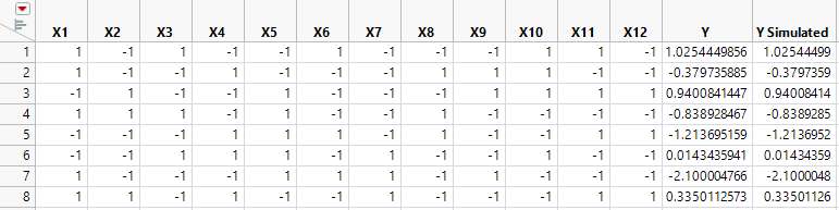

Figure 5.13 Design Table with Simulated Responses
The response columns, Y and Y Simulated, are initiated with the same simulated values. The values are random values from a N(0, s) distribution. where s is the RMSE from the power analysis with a default of 1. The Y Simulated values are updated with randomly generated values using the model defined by the parameter values in the Simulate Responses window. The Y column is intended for your true responses after the experiment has been run.

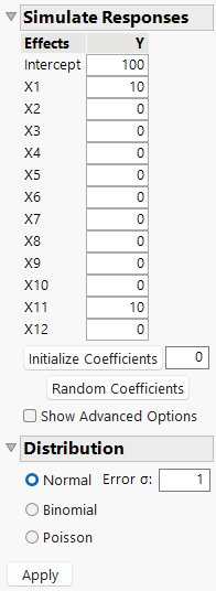

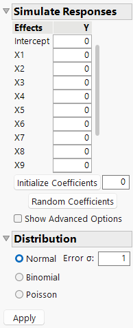

Figure 5.14 Simulate Responses Window
The Simulate Responses window shows default coefficients of 0 for all terms, a Normal distribution selection and Error σ of 1. The values in the Y and Y Simulated column currently reflect only random variation.
13. Change the values of the coefficients in the Simulate Responses window as shown in Figure 5.15.
Figure 5.15 Parameter Values for Simulated Responses
14. Click Apply.
The response values in the Y Simulated column change.
In your simulation, you specified X1 and X11 as active factors with large effects relative to the error variation. For this reason, your analysis of the data should identify these two factors as active.

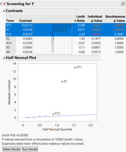

Analyze a Supersaturated Design Using the Fit Two Level Screening Platform
The Fit Two Level Screening platform provides an analysis method to identify active factors.
Note: Your data table might have slightly different Y Simulated values than those in this example. The exact values in your reports can differ from the results shown here.
1. Select DOE > Classical > Factor Screening > Fit Two Level Screening.
2. Select Y Simulated and click Y.
3. Select X1 through X12, click X and click OK.
Figure 5.16 Screening Report for Supersaturated Design
The factors X1 and X11 have large contrast and Lenth t-Ratio values. Also, their Simultaneous p-Values are small. In the Half Normal Plot, both X1 and X11 fall far from the line. The Contrasts and the Half Normal Plot reports indicate that X1 and X11 are active effects. Although X12 has an Individual p-Value less than 0.05, its effect is much smaller than that of X1 and X11.
Because the design is supersaturated, p-values might be smaller than they would be in a model where all effects are estimable. This is because effect estimates are biased by other potentially active main effects. In Figure 5.16, a note warns you of this possibility.
You can check whether the effects that appear active are highly correlated with other effects. When this occurs, one effect can mask the true significance of another effect. The Color Map in Figure 5.18 displays absolute correlations between effects.
4. Click Make Model.
The constructed model contains only the effects X1, X11, and X12.

Figure 5.17 Parameter Estimates for Model
Note that the parameter estimates for X11 and X1 are close to the values that you used to simulate the model. See Figure 5.15, where you specified a model with X1 = 10 and X11 = 10. The significance of the factor X12 is an example of a false positive.
