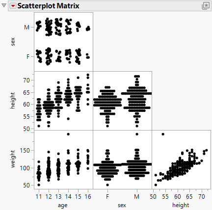

The Scatterplot Matrix window shows an ordered grouping of bivariate graphs. In each graph, you can examine the relationships between each pair of variables.
Follow the instructions in Example of a Scatterplot Matrix to produce the plot that is shown in Figure 6.9.
Note: For information about additional options, see Scatterplot Matrix Platform Options.
Figure 6.9 Example of a Scatterplot Matrix Window
