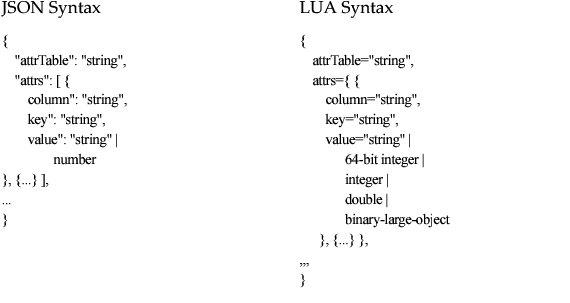

For example, in Figure 14.6, notice the difference between the JSON syntax and the Lua syntax. JSON uses the "name" : value format. Lua uses the name = value syntax.
Figure 14.6 Differences Between JSON and LUA
