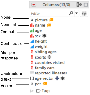

Figure 5.3 illustrates the icons that identify the different modeling types.
Figure 5.3 Modeling Type Icons in the Columns Panel
Click an icon to change the modeling type to Continuous, Nominal, Ordinal, or None. See Modeling Type.
