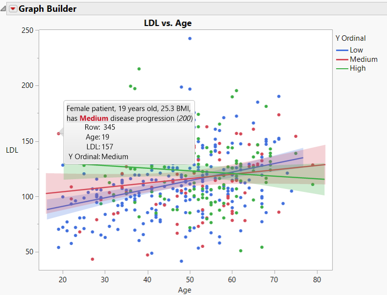

A textlet adds richly formatted text to the hover label in a JMP graph. You might use a textlet to describe data in an explanatory paragraph or to emphasize important information by making it bold or applying a color.
The textlet in Figure 12.39 shows text that is formatted in a gray box with red text.
Figure 12.39 Textlet Example
Textlet Example
The following script creates the textlet shown in Figure 12.39.
