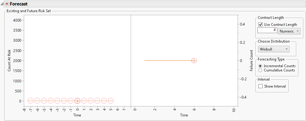

10. Set the past 7 months of production counts. In the left Forecast graph, drag the leftmost animated hotspot left to -7.
11. Set the future 5 months of production estimates. In the left Forecast graph, drag the rightmost animated hotspot right to 5.
Figure 4.14 Risk Set after Dragging Animated Hotspots

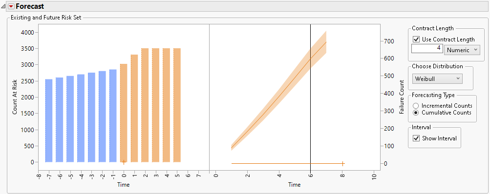

15. In the right Forecast graph, drag the animated hotspot right to 8.
16. In the Forecasting Type panel, select Cumulative Counts.
17. In the Interval panel, select Show Interval.
18. Right-click the horizontal axis in the right Forecast graph and select Axis Settings. Add a reference line at month 6 using the following steps:
1. Type 6 for the Value.
2. Click Add.
3. Click OK.
The forecast for the total number of units that will be returned for repair in the next 6 months is approximately 600 with confidence interval about 550 to 650.

Figure 4.16 Forecast Results
Forecast Results
