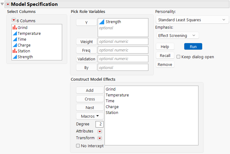

The Model Specification window shows the effects that you specified in the Model section.
Figure 3.12 Model Specification Window
3. Select the Keep dialog open option.
4. Click Run.

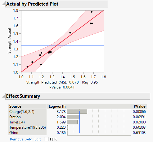

Figure 3.13 Effect Summary and Actual by Predicted Plot for Full Model
Note the following findings:
The Actual by Predicted Plot shows no evidence of lack of fit.
The model is significant, as indicated by the Actual by Predicted Plot. The notation P = 0.0041, shown below the plot, gives the significance level of the overall model test.
The Effect Summary report shows that Charge, Station, and Time are significant at the 0.05 level.
The Effect Summary report also shows that Temperature and Grind are not significant.

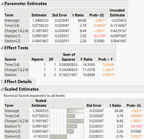

Figure 3.14 Partial Output for the Reduced Model
The Effect Tests report shows that all three effects remain significant.
The Scaled Estimates report further indicates that the Station[1]and Station[3] means differ significantly from the average response of Strength.
Note that the Estimates that appear in the Parameter Estimates report are identical to their counterparts in the Scaled Estimates report. This is because the effects are coded. See “Coding”.
The estimate of the Station[3] effect appears only in the Scaled Estimates report, where nominal factors are expanded to show estimates for all their levels.
The Parameter Estimates report gives estimates for the model coefficients where the model is specified in terms of the coded effects.

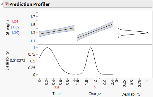

Figure 3.15 Prediction Profiler
Prediction Profiler
Recall that, in designing your experiment, you set a response Goal of Match Target with limits of 1.2 and 1.4. JMP uses this information to construct a desirability function to reflect your specifications. See “Factors”.
Note the following findings in the prediction profiler:
The first two plots in the top row of the graph show how Strength varies for one of the factors, given the setting of the other factor. For example, when Charge is 2, the line in the plot for Time shows how predicted Strength changes with Time.
The values to the left of the top row of plots give the Predicted Strength (in red) and a confidence interval for the mean Strength (in blue) for the selected factor settings.
The right-most plot in the top row shows the desirability function for Strength. The desirability function indicates that the target of 1.3 is most desirable. Desirability decreases as you move away from that target. Desirability is close to 0 at the limits of 1.2 and 1.4.
The plots in the bottom row show the desirability trace for each factor at the setting of the other factor.
The value to the left of the bottom row of plots gives the Desirability of the response value for the selected factor settings.
Explore various factor settings by dragging the red dashed vertical lines in the columns for Time and Charge. Since there are no interactions in the model, the profiler indicates that increasing Charge increases Strength. Also, Strength seems to be more sensitive to changes in Charge than to changes in Time.

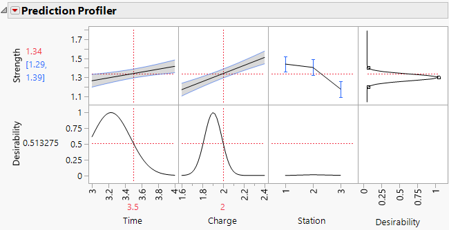

Plots for Station appear in the Prediction Profiler.
5. Click in either plot above Station to insert a dashed red vertical line.
6. Move the dashed red vertical line to Station 1.
Figure 3.17 Prediction Profiler That Shows Results for Station 1
7. Move the dashed red vertical line to Station 3.
Figure 3.18 Prediction Profiler That Shows Results for Station 3
The predicted Strength in the center of the design region for Station 1 is 1.44. For Station 3, the predicted Strength is about 1.18. The magnitude of the difference indicates that you need to address Station variability. Better control of Station variation should lead to more consistent Strength. Once Station consistency is achieved, you can determine common optimal settings for Time and Charge.
