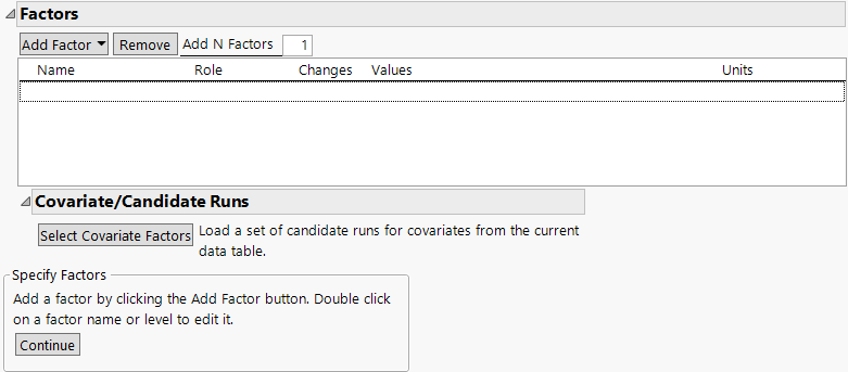

In the Factors section, add factors that you want to study in a custom design.
Tip: When you have completed the Factors section, consider selecting Save Factors from the red triangle menu. This saves the factor names, roles, changes, and values in a data table that you can later reload.
Figure 4.17 Factors Section
Factors Section
Add Factor
Select the factor type. See Factor Types.
Remove
Removes the selected factors.
Note: If you attempt to remove all factors after clicking the Continue or Back button, one continuous factor remains. You can delete it after you add new factors.
Add N Factors
Adds multiple factors. Enter the number of factors to add, click Add Factor, and then select the factor type. Repeat Add N Factors to add multiple factors of different types.

Editing the Factors
In the Factors section, use the following actions to edit factor properties:
To edit a factor name, double-click the factor name.
Categorical factors have a down arrow to the left of the factor name. Click the arrow to add a level.
To remove a factor level, click the value, click Delete, and click outside the text box.
To modify the entry under Changes, click the value in the Changes column and select the appropriate entry.
To edit a value, click the value in the Values column.

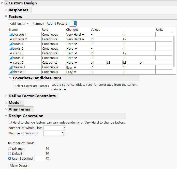

Figure 4.18 shows a split-split-plot scenario, using the factors from the Cheese Factors.jmp sample data table (located in the Design Experiment folder).
Figure 4.18 Factors and Design Generation for a Split-Split-Plot Design
If you assign Changes as Hard for one or more factors, but no factors are assigned Changes that are Very Hard, a categorical factor called Whole Plots is added to the design. This situation results in a split-plot design:
Each level of Whole Plots corresponds to a block of constant settings of the hard-to-change factors.
The Model script in the design table applies the Random Effect attribute to the factor Whole Plots.
The factor Whole Plots is assigned the Design Role column property with a value of Random Block.
When you designate Changes as both Hard and Very Hard, categorical factors called Subplots and Whole Plots are added to the design. This situation results in a split-split-plot design:
Each level of Subplots corresponds to a block of constant settings of the hard-to-change factors.
Each level of Whole Plots corresponds to a block of constant settings of the very-hard-to-change factors.
The Model script in the design table applies the Random Effect attribute to the Whole Plots and Subplots effects.
The levels of the hard-to-change factor are assumed to be nested within the levels of the very-hard-to-change factor by default.
In the design table, both of the factors Whole Plots and Subplots are assigned the Design Role column property with a value of Random Block.
