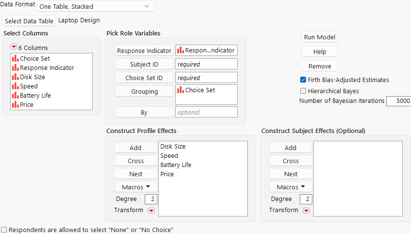

1. Select Help > Sample Data Folder and open Design Experiment/Laptop Design.jmp.
2. Run the Choice script.
Figure 18.6 Choice Model Launch Window
The only grouping variable is Choice Set because there is a single survey and a single respondent.
3. Click Run Model.
