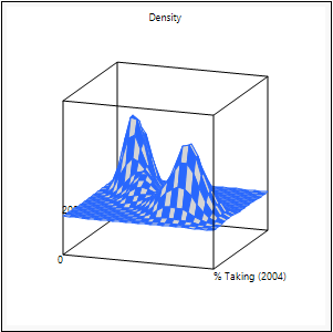

Mesh Plot
Shows or hides a three-dimensional plot of the density over a grid of the two analysis variables.
Figure 5.6 Example of a Mesh Plot
