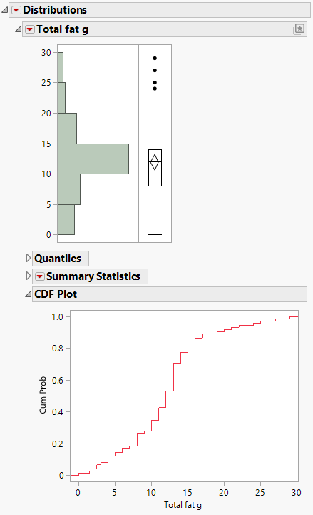

Use the CDF Plot option in the Distribution platform to create a plot of the empirical cumulative distribution function. Use the CDF plot to determine the percent of data that is at or below a given value on the horizontal axis. When a distribution is fit to the data, the cumulative distribution function for the fitted distribution is overlaid on the CDF plot.
Figure 3.9 CDF PlotĀ
CDF Plot
For example, in this CDF plot, approximately 34% of the data are less than a total fat value of 10 grams.
