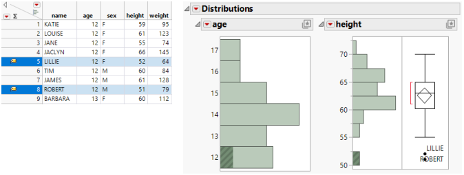

The Distribution report window is interactive. Clicking on a histogram bar highlights the corresponding data in any other histograms and in the data table.
Figure 3.1 Example of the Distribution Platform
