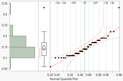

Normal Quantile Plot
Use the Normal Quantile Plot option in the Distribution platform to visualize the extent to which the variable is normally distributed. If a variable is normally distributed, the normal quantile plot approximates a diagonal straight line. This type of plot is also called a quantile-quantile plot, or Q-Q plot.
The normal quantile plot also shows Lilliefors confidence bounds (Conover 1980) and probability and normal quantile scales.
Figure 3.6 Normal Quantile Plot
Note the following about normal quantile plots:
The vertical axis shows the column values.
The upper horizontal axis shows the normal quantile scale.
The lower horizontal axis shows the empirical cumulative probability for each value.
The dashed red line shows the Lilliefors confidence bounds.
For statistical details, see Statistical Details for the Normal Quantile Plot.
