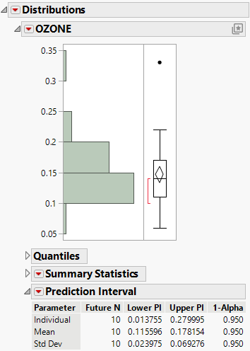

5. Click the OZONE red triangle and select Prediction Interval.
Figure 3.18 The Prediction Intervals Window
6. In the Prediction Intervals window, type 10 next to Enter number of future samples.
7. Click OK.
Figure 3.19 Example of a Prediction Interval Report
In this example, you can be 95% confident about the following findings:
Each of the next 10 observations are likely to fall between 0.013755 and 0.279995.
The mean of the next 10 observations is likely to fall between 0.115596 and 0.178154.
The standard deviation of the next 10 observations is likely to fall between 0.023975 and 0.069276.
