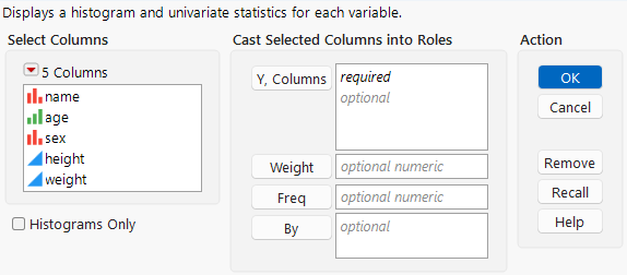

Launch the Distribution platform by selecting Analyze > Distribution.
Figure 3.4 The Distribution Launch Window
Y, Columns
Assigns the variables that you want to analyze. A histogram and associated reports appear for each variable.
Weight
Assigns a variable that specifies weights for continuous responses. For categorical responses, the Weight column is ignored. Weights of zero result in the exclusion of the observation from the histogram and all calculations, including quantiles. For more information about summary statistics calculations with weights, see Statistical Details for Summary Statistics.
Freq
Assigns a frequency variable to this role. This is useful if your data are summarized. In this instance, you have one column for the response and another column for the frequency of the occurrence of the response. The sum of this variable is included in the overall count appearing in the Summary Statistics report (represented by N). All other moment statistics (mean, standard deviation, and so on) are also affected by the Freq variable.
By
Produces a separate report for each level of the By variable. If more than one By variable is assigned, a separate report is produced for each possible combination of the levels of the By variables.
Create Process Capability
(Appears only if a column contains a Spec Limits column property.) Adds a Process Capability report for the analysis columns that contain a Spec Limits column property.
Histograms Only
Removes everything except the histograms from the report window.
