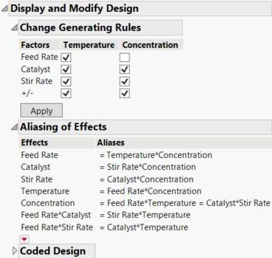

Figure 10.13 shows the default-generating rules for a 25-2 fractional factorial design (five factors and eight runs).
Figure 10.13 Generating Rules for the Standard 25-2 Design
In each column of the Change Generating Rules panel, the factor listed at the top and the factors in the column whose boxes are selected form a word in the defining relation. For example, the first column indicates that Temperature = Feed Rate*Catalyst*Stir Rate is a word in the defining relation.
If the +/- box is selected, the sign associated with the generating rule is positive and the corresponding word equals the identity.
If the +/- box is not selected, the sign associated with the generating rule is negative and the corresponding word equals minus the identity.
See Obtain the Defining Relations in the 25-2 Design.
Figure 10.13 shows two columns of check boxes:
The first column represents the word Temperature = Feed Rate*Catalyst*Stir Rate.
The second column represents the word Concentration = Catalyst*Stir Rate.
Define I to represent a column consisting of the values +1. Because all factor levels are -1 or +1, the word in the first column is equivalent to Temperature*Feed Rate*Catalyst*Stir Rate = I. The word in the second column is equivalent to Concentration*Catalyst*Stir Rate = I. Together, these give the defining relations for the 25-2 design:
I = Temperature*Feed Rate*Catalyst*Stir Rate = Concentration*Catalyst*Stir Rate
