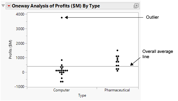

Figure 5.15 Profits by Company Type
There is an outlier in the Computer Type. The outlier is stretching the scale of the plot and making it difficult to compare the profits. Exclude and hide the outlier:
1. Click the outlier.
2. Select Rows > Exclude/Unexclude.
The data point is no longer included in calculations.
3. Select Rows > Hide/Unhide.
The data point is hidden from all graphs.
4. To re-create the plot without the outlier, click the red triangle next to Oneway Analysis of Profits ($M) By Type and select Redo > Redo Analysis.
You can close the original Scatterplot window.

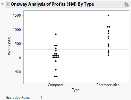

Figure 5.16 Updated Plot
Updated Plot
Removing the outlier gives the financial analyst a clearer picture of the data.

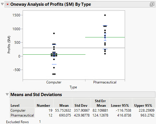

5. To continue analyzing the relationship, select these options from the red triangle next to Oneway Analysis of Profits ($M) By Type:
Display Options > Mean Lines. This option adds mean lines to the scatterplot.
Means and Std Dev. This option displays a report that provides averages and standard deviations.
Figure 5.17 Mean Lines and Report
Interpret the Results
The financial analyst wanted to know how the profits of computer companies compared to the profits of pharmaceutical companies. The updated scatterplot shows that pharmaceutical companies have higher average profits than computer companies. In the report, if you subtract one mean value from the other, the difference in profit is approximately USD 635 million. The plot also shows that some of the computer companies have negative profits and all of the pharmaceutical companies have positive profits.

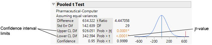

Perform the t Test
The financial analyst has looked at only a sample of companies (the companies in the data table). The financial analyst now wants to examine these questions:
Does a difference exist in the broader population, or is the difference of USD 635 million due to chance?
If there is a difference, what is it?
To answer these questions, perform a two-sample t test. A t test lets you use data from a sample to make inferences about the larger population.
To perform the t test, click the red triangle next to the Oneway Analysis of Profits ($M) By Type and select Means/Anova/Pooled t.
Figure 5.18 Pooled t Test Results
The p-value of 0.0001 is less than the significance level of 0.05, which indicates statistical significance. Therefore, the financial analyst can conclude that the observed difference in average profits for the sample data is statistically significant. This means that in the larger population, the average profits for pharmaceutical companies are different from the average profits for computer companies.
Draw Conclusions
Use the confidence interval limits to determine how much difference exists in the profits of both types of companies. Look at the Upper CL Dif and Lower CL Dif values in Figure 5.18. The financial analyst concludes that the average profit of pharmaceutical companies is between USD 343 million and 926 million higher than the average profit of computer companies.
