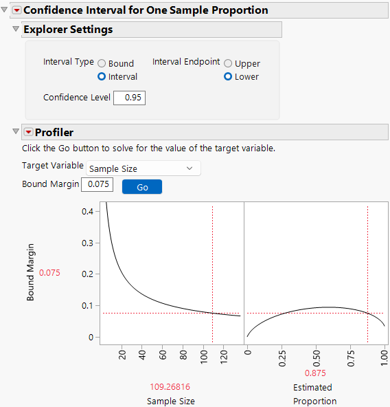

In this example, use the Confidence Interval for One Sample Proportion to calculate the sample size that is needed to demonstrate that the lower confidence limit on a two sided interval for an estimated proportion of 0.875 is at least 0.8 with 95% confidence.
1. Select DOE > Sample Size Explorers > Confidence Intervals > Confidence Interval for One Sample Proportion.
2. Leave Interval Type set to Interval for estimating a sample size for a two-sided confidence interval.
3. Leave Confidence Level set to 0.95.
4. Set Interval Endpoint to Lower for the lower bound margin.
5. Leave Target Variable set to Sample Size.
6. Set Bound Margin to 0.075.
7. In the profiler, set Estimated Proportion to 0.875.
8. Click Go.
Figure 29.9 Confidence Interval Explorer for One Sample Proportion
A sample size of 110 (109.2 rounded up to a whole unit) is needed to obtain a lower limit of 0.80 for an estimated proportion of 0.875 (0.875 - 0.075 = 0.80). This is based on a two-sided 95% confidence interval.
