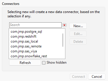

2. Click New Connection.
The Select Data Connector window displays the New Connection window.
Figure 3.51 The New Connection Window
3. Select a data connector from the registry of built-in connectors, add-in connectors supplied by your organization, and user-created connectors.
Built-in connectors are prefixed with com.jmp, add-in connectors are prefixed with an add-in ID, and user-created connectors have no prefix. New connectors must be configured by using the configuration options listed in Configure a Data Connector.
4. With a configured data connector selected, click Connect.
The New Connection window closes, returning you to the Select Data Connector window.

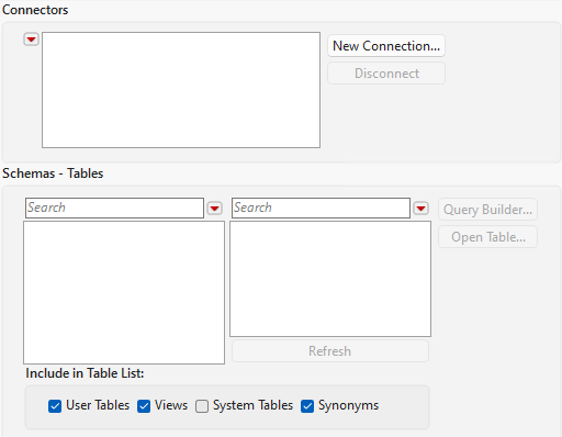

1. Select File > Connect To > Data Connectors.
The Select Data Connector window appears (Figure 3.52).
2. If you are already connected to the database, select it in the Connections box.
The Connectors box lists data sources to which JMP is connected. The Schemas - Tables box lists schemas for the databases that support them.
Figure 3.52 Select Data Connector Window Before Establishing Any Connections
3. If the wanted data source is not listed in the Connectors box, click New Connection to choose a data connector.
Follow the steps in Configure a Data Connector.
4. Select the wanted data source in the Connectors box.
The tables list in the Tables box updates accordingly. The update might take several seconds, depending on the number of tables and the speed of the connection to the database. If your database supports schemas, tables are loaded for the first schema in the list. Tables for other schemas are loaded as you click them.

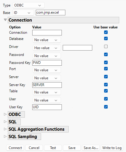

The Data Connector Editor window appears after selecting New in the Select Data Connector window. Configure options for connecting to a database in this window, such as login credentials and SQL formatting.
Options that accept a Boolean accept the values ON and OFF.
Figure 3.53 The Data Connector Editor Window
Data Connector Editor Window Options
2. Select New Connection.
3. Select a previously configured and connected data connector and then select Edit.

2. Select New Connection to choose a data connector.
3. In the window that appears, select com.jmp.excel from the list of available data connectors.
4. Select New.
The Data Connector Editor window appears.
5. In the Connection field, provide the path to the file that you want to connect to in the following format:
DBQ={C:\Users\YourName\Documents\data.xslx};
6. Select Connect to connect to the provided XLSX file.
