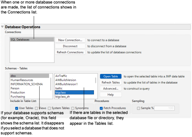

The Database Open Table window appears (Figure 3.55).
2. If you are already connected to the database, select it in the Connections box.
Follow the steps in Connect to a Database With Open Table.
The Connections box lists data sources to which JMP is connected. The Schemas - Tables box lists schemas for the databases that support them.

4. Select the wanted data source in the Connections box.
The tables list in the Tables box updates accordingly. The update might take several seconds, depending on the number of tables and the speed of the connection to the database. If your database supports schemas, tables are loaded for the first schema in the list. Tables for other schemas are loaded as you click them.
5. Control which tables are listed by choosing the options in the Include in Table List group of check boxes.

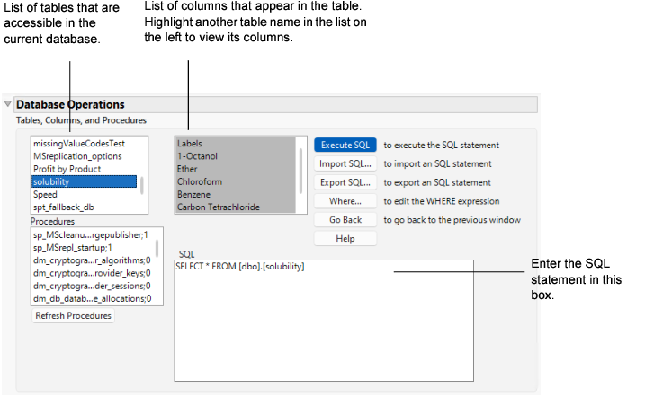

3. From the Database Open Table window, click the Advanced button to open specific subsets of a table.
4. Either enter a valid SQL statement or modify the default statement.
Figure 3.56 shows a default SQL SELECT statement that is appropriate for the selected file. For a description of SQL statements that you can use, see Structured Query Language (SQL): A Reference.
Instead, you can add expressions by clicking the Where button and using the WHERE Clause editor to create expressions. See Use the WHERE Clause Editor.
Figure 3.56 Reading All Variables from the Solubility Table Stored in an Excel File
5. Click Execute SQL.
A JMP data table appears with the columns that you selected. See “Use Data Table Variables”.
