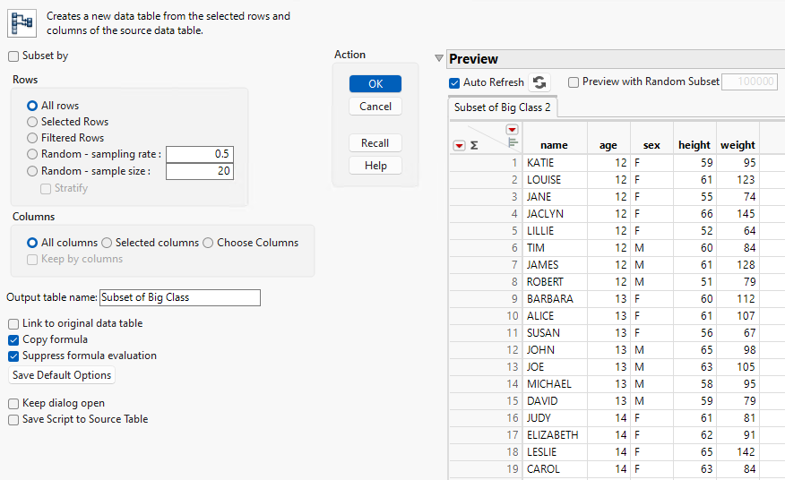

To create a subset
1. Select Tables > Subset.
Figure 6.2 The Subset Window
The Subset Window
2. Specify the content that you want to subset.
Select any combination of the following choices:
Subset by (the levels within selected columns)
Rows (all, selected, or random)
Columns (all or selected)
3. Customize your subset table further by using the additional options.
4. Click OK to create the subset table.

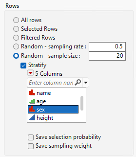

Stratified Subsets
In the JMP Subset window, if you specify a sample size and add stratification columns, the sample size represents the size per stratum, rather than the size of the whole subset.
Figure 6.3 Stratified Subsets
Stratified Subsets
For stratified random samples with a specified sample size, two columns can be saved: Selection Probability and Sampling Weight. Check the corresponding check box to save these columns.
