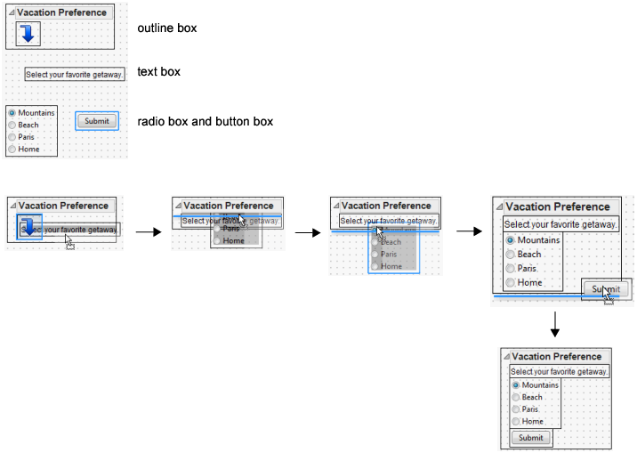

Drag an Object
One way to position objects is by dragging them around the workspace.
The top and left edges of an object align (or snap) to the nearest dotted grid lines as you drag them on the workspace. For a more precise placement, click the Application Builder red triangle and deselect Snap to Grid. You can also turn off Snap to Grid for all applications in the JMP Preferences. Select File (Windows) or JMP (Apple macOS)> Preferences > Platforms > JMP App to change the option.
Position objects in containers instead of positioning them independently on the workspace. For example, place two button boxes in a V List Box to align them vertically.
When you drag an object, press Shift to restrict movement to a single axis (for example, to move the object horizontally without moving the vertical position).
When you drag an object into a container, the arrow indicates where you can drop the object.
When you drag an object over another one, a blue line shows where you can drop the object.
Figure 18.5 shows the various methods for dragging objects inside a container.
Figure 18.5 Examples of Dragging Objects into a Container

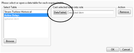

Label
Specifies the string used when prompting the user to open a data table. Figure 18.9 shows the default value.
Figure 18.9 Label in Data Table Prompt Window

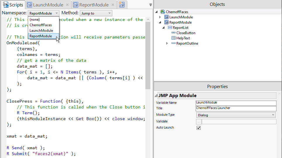

To see the scripts in these namespaces, click the Scripts tab and then select the namespace in the Namespace list (or in the Objects panel).
Figure 18.10 Application and Module Namespaces

A named script is a function that several controls can use. The this argument tells which control is calling the function. In the following example, Get Button Name is sent to the this argument to print the button name to the log when the button is clicked:
Button1Press = Function({this}, Print(this <<Get Button Name))
On another button, use Button1Press script to produce the same results.
Two other advantages of named scripts: when you add a named script to an object, JMP inserts a placeholder script on the Scripts tab, which you then edit. On the Scripts tab, you can also select a script from the Method list to navigate to that code, which is particularly helpful in long scripts.

Double-click the object on the Module tab.
When an object has multiple scripts, right-click the object, select Scripts, and then select the script name. You can also select the Scripts tab, select the module name from the Namespace list and then select the script name from the Method list. Likewise, to see the application scripts, select Application from the Namespace list.
In each case, the Scripts tab appears with the cursor in the first line of the object’s script.
Tip: To make a poorly formatted script easier to read, right-click and select Reformat Script.
