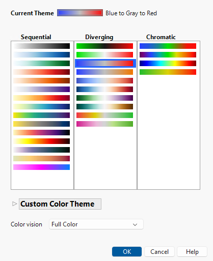

If you are creating a new continuous color theme, the Continuous Color Themes window appears.
Figure 4.32 Continuous Color Themes Window

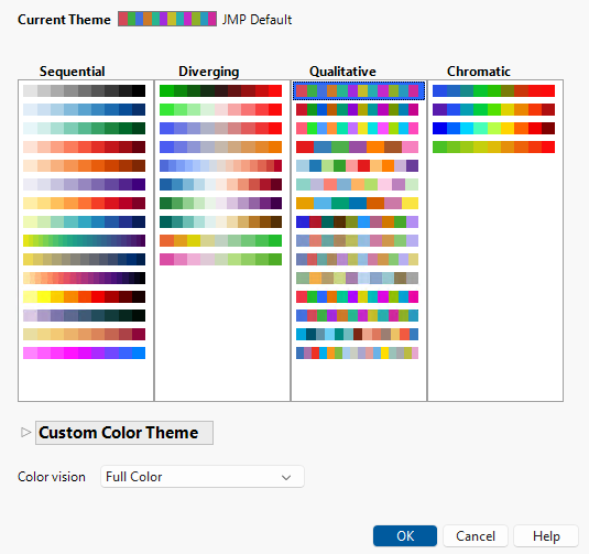

If you selected to create a new categorical color theme, the Categorical Color Themes window appears.
Figure 4.33 Categorical Color Themes Window

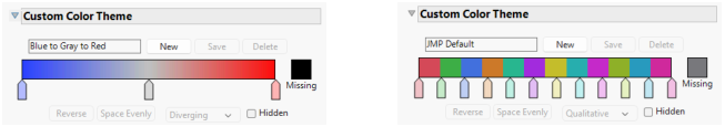

4. Click the Custom Color Theme disclosure icon to show the Custom Color Theme panel.
Figure 4.34 shows the color theme panels for both continuous and categorical themes (respectively).
Figure 4.34 Custom Color Theme Panel

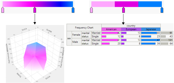

Figure 4.35 shows examples of the two types of color themes in JMP, continuous and categorical. When a color theme is selected for continuous data, the colors are graduated (as shown on the left side of the image). When the same color theme is selected for categorical data, the color consists of distinct blocks of color (as shown on the right side of the image).
Figure 4.35 Examples of Continuous and Categorical Color Themes
