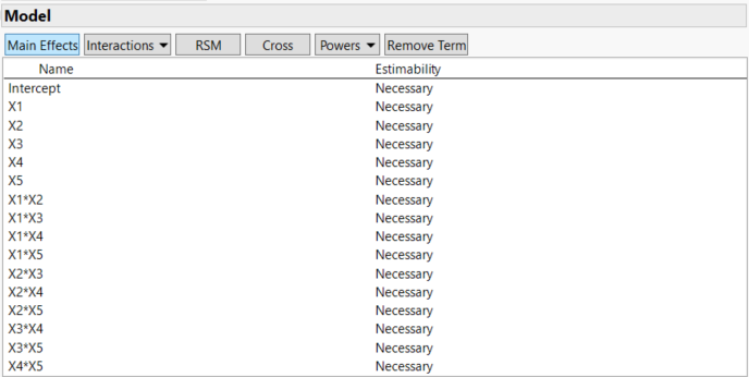

5. In the Model section, select Interactions > 2nd.
Figure 5.6 Model with Interactions

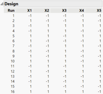

Figure 5.7 shows the runs of the design. All main effects and two-factor interactions are estimable because their Estimability was designated as Necessary (by default) in the Model section.
Figure 5.7 Design to Estimate All Two-Factor Interactions
